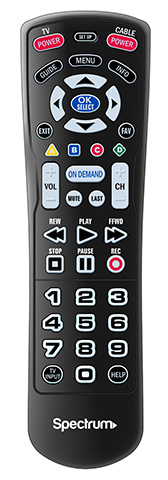

Setup Method A: Popular Brands
Note: Make sure the TV is ON before starting remote control setup.
  1. Press and hold SETUP until the LED blinks twice.
  2. Press the TV POWER key.
  3. Press and hold down the DIGIT key for your tv brand.
    Digit TV
    1 Insignia/Dynex
    2 LG/Zenith
    3 Mitsubishi
    4 Panasonic
    5 Philips/Magnavox
    6 Samsung
    7 Sharp
    8 Sony
    9 Toshiba
    0 Vizio
  4. Let go of the key when your TV turns off. Setup is complete.
Note: if your brand does not appear on the chart above, try either Method B or Method C to setup the remote to control your TV.
Setup Method B: Code Search
  3. Press and hold down the OK/Select key.
  4. Let go of the OK/Select key when the TV turns off.
Setup Method C: Direct Code Entry
  1. Press the TV POWER key.
  2. Press and hold SETUP until the LED blinks twice.
  3. Enter the 1st TV code for your brand from the list of codes above.
  4. Press the TV POWER key to test TV control. If the TV turns off, setup is complete.
  5. If the TV does not turn off, repeat this process using the next code for your TV brand.
Troubleshooting
Problem: LED does not blink when a key is pressed.
Solution: Replace batteries.
Problem: TV does not respond when TV POWER or VOLUME keys are pressed.
Solution: Program remote control for your TV brand using instructions in Setup Method A, B, or C.
Problem: Tried all codes for my TV brand and none work.
Solution: Try Setup method B.
