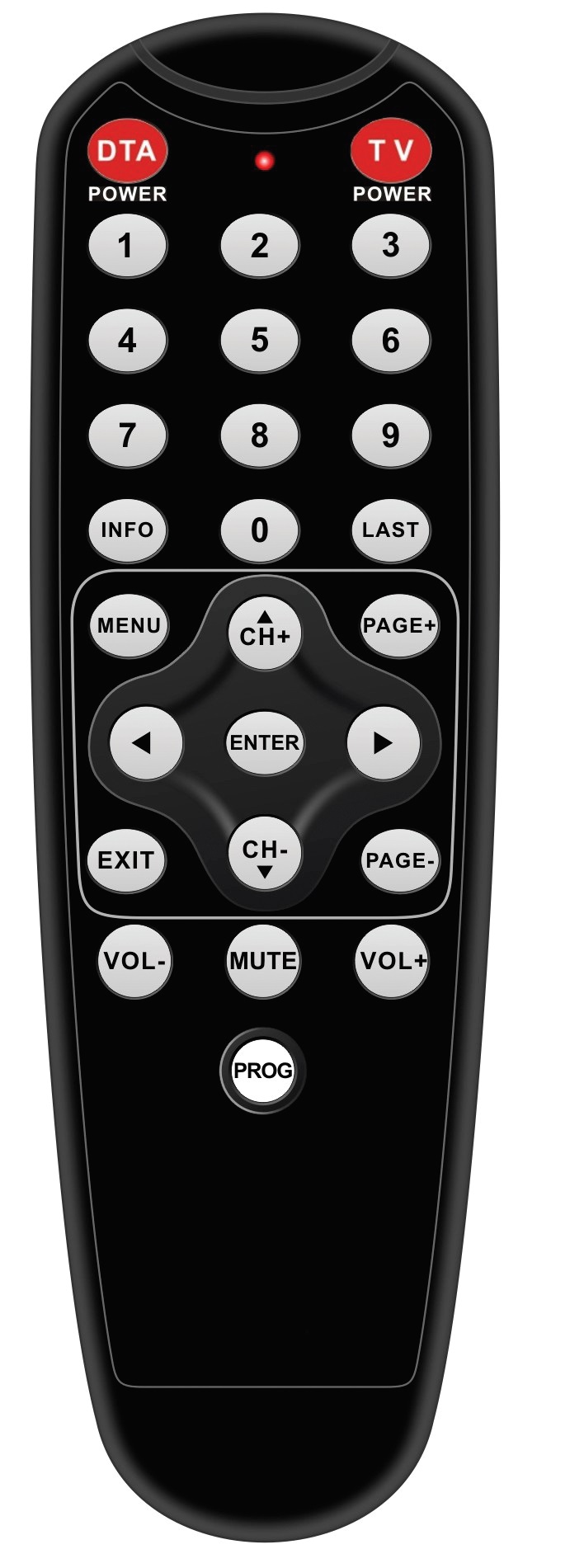

Program the Remote to Control Your TV
  1. Turn on your TV.
  2. Press and hold the PROG key for three seconds or until the LED turns on then press the TV key. The LED will blink once and stay on.
  3. Find the four digit device code for your TV brand. Press and release the four numeric keys.
  4. If the device code is valid, the LED will blink two times and the device code will be retained. If the device code is invalid, the LED will blink three times - either input another code or cancel the remote programming by pressing the TV key.
Automatic Code Search
If the device code for your TV brand can't be found in the list above, you can access the device code database using Code Search.
  1. Turn the TV on manually.
  2. Press and hold the PROG key for three seconds or until the LED turns on.
  3. Press the CH+ key to enter the automatic code search mode. The remote will transmit the TV power code every 1.5 seconds and the LED will blink at the same time. When your TV turns off, the remote has found a valid code.
  4. Press the TV key to store the code and exit search mode.
Pairing Between Remote Control and Target Device (DTA)
Your remote control can be paired with the DTA, allowing you to place the DTA out of the line of sight (e.g. behind your TV).
  1. Turn on the target (DTA) device.
  2. Press and hold the PROG key for three seconds or until the LED turns on, then press the INFO key.
  3. The LED on the remote control will blink slowly to indicate that the device is in pairing mode.
  4. The DTA will prompt the user via a message on the TV to enter a unique four digit number.
  5. If the four digits entered are correct, the target (DTA) will prompt the user that the pairing was successful.
  6. If the four digits entered are incorrect, the target (DTA) will prompt the user that the pairing has failed and to try again until the correct code is entered.
Unpairing the DTA
Once paired with the target (DTA), the remote can be unpaired using the following sequence:
  1. Press and hold the PROG key for three seconds or until the LED turns on.
  2. Press 9 8 7, the LED will blink two times quickly to show the procedure is successful.
Switching Between DTA and TV Mode for Volume/Mute Control
To control DTA Volume and Mute, use the following steps:
  2. Press the VOL- key.
    To control TV Volume and Mute, use the following steps:
    2. Press the VOL+ key.
Default state: the remote is initially assigned to control DTA Volume and Mute.
