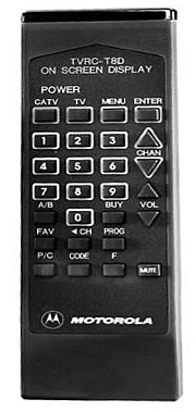

Programming Your Spectrum Receiver (Cable Box)
The Motorola TVRC is designed to work with General Instruments Spectrum Receivers CFT-2000, CFT-2200 and WNR-2000 with out the need for programming. To program other receivers, press the F button on your remote control followed by the A/B button and the three-digit programming code listed for your device.
Programming the TV
- Look up the three-digit programming code for your TV.
- Using your remote, press the F button and then the TV button.
- Enter the first three-digit programming code for your TV manufacturer.
- If you want to control the volume through your TV, press the TV button. If you want to control the volume through your receiver, press the CATV button.
- Pressing the TV button on your remote control should now turn your TV on and off. If not, repeat the procedure using the next manufacturer code.
Search for the TV Code
- Using your remote, press F, then TV, then SEL and then TV again.
- If your TV turns on or off, press ENTER.
- If not, continue pressing SEL, then TV until it does.
- When your TV turns on or off, press ENTER.
