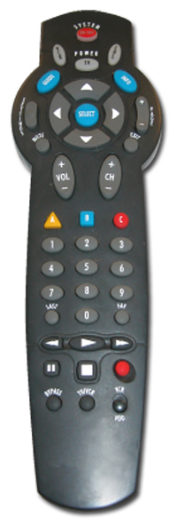

How to Identify Programmed Codes
  1. Point the remote control away from the EXPLORER 2000 DHCT , the TV, and the VCR.
  2. Do one of the following: To identify the TV code, press and hold the TV key and the SELECT key at the same time until the LED on the remote control blinks twice, or to identify the VCR code, press and hold the VCR key and the SELECT key at the same time until the LED on the remote control blinks twice.
  3. Using the remote control keypad, enter 990. The LED on the remote blinks twice.
  4. Press 1 on the keypad; then, count the LED blinks. The number of blinks indicates the first number in the code. For example, four blinks indicates the first number in the code is 4. If the LED does not blink, the digit is 0 (zero).
  5. Press 2 on the keypad; then, count the LED blinks. The number of blinks indicates the second number in the code.
  6. Press 3 on the keypad; then, count the LED blinks. The number of blinks indicates the third number in the code.
  7. Write down the code for future reference.
How to Program the Volume Control
  1. Point the remote control away from the EXPLORER 2000 DHCT, the TV, and the VCR.
  2. Press and hold the [CBL] key and the SELECT key at the same time until the LED on the remote control blinks twice.
  3. Using the remote control keypad, enter 993. The LED on the remote blinks twice.
  4. Press the TV key or the CBL key, depending on which device you want to control the volume. The LED on the remote control blinks twice to confirm a valid selection.
  5. Point the remote toward the device for which you chose to control the volume, and adjust the volume to confirm operation.
How to Program for TV Operation
  1. Make sure the power to your TV is turned on before you program the remote control. Locate your TV brand and TV setup code in the programming codes lists. If your TV brand is not listed, see Searching the Code Library.
  2. Point the remote control away from the DHCT, TV, and VCR.
  3. On your remote control, press and hold the TV key and the SELECT key at the same time until the LED on the remote blinks twice.
  4. Using the remote control keypad, enter your TV's three-digit setup code. The LED on the remote control should blink twice. If not, try another setup code, if available.
  5. Confirm by pointing the remote control toward the TV and test the POWER, VOLUME, and MUTE functions.
    Note: If you programmed the remote control to adjust the volume on your DHCT rather than the volume on the TV, test only the POWER function. If these functions do not operate from the remote control, enter the next TV setup code from the list and repeat this procedure from step 1.
How to Program for VCR Operation
  1. Make sure the power to your VCR is turned on before you program the remote control. Move the VCR/VOD slide switch on the remote control to the VCR position.
  2. Locate your VCR brand and VCR setup code in the programming codes lists. If your VCR brand is not listed, see Searching the Code Library.
  3. Point the remote control away from the DHCT, the TV, and the VCR.
  4. On your remote control, press and hold the VCR key and the SELECT key at the same time until the LED on the remote blinks twice.
  5. Using the remote control keypad, enter your VCR's three-digit setup code. The LED on the remote control should blink twice. If not, try another setup code, if available.
  6. Confirm by pointing the remote control toward the VCR and test the POWER, PLAY, and STOP functions. If these functions do not operate from the remote control, enter the next VCR setup code in the list and repeat this procedure from step 1.
  1. Point the remote control away from your TV or VCR depending on which device you are programming.
  2. Do one of the following: To search for TV codes, press and hold the TV key and the SELECT key at the same time until the LED on the remote control blinks twice. To search for VCR codes, press and hold the VCR key and the SELECT key at the same time until the LED on the remote control blinks twice.
    Note: The LED on the remote control also blinks twice when it reaches the end of its search library.
  3. Using the remote control keypad, enter 991. The LED on the remote blinks twice.
  4. Point the remote control toward your TV or VCR, and press the TV key or the VCR key depending on which device you are programming.
  5. Did the TV or VCR turn off? If yes, go step 6. If no, repeat step 4.
  6. Press the SELECT key to confirm a valid code. The remote control LED blinks twice.
  7. Point the remote toward the device you programmed and press POWER to confirm that the device turns on and off.
