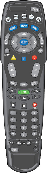

Assigning a Different Device Code to a Mode Key
  1. Find the codes for your brand of device in the appropriate setup code list. For example, look under TV Group if you need to program the remote to operate your TV.
  2. Turn on your device.
  3. Press and hold SELECT and the appropriate mode key until all of the mode keys blink twice. For example, to set up the TV, press and hold SELECT and TV.
    Note: If you reassigned mode keys, you may, for example, press SELECT and VCR to program the VCR mode key with a TV code.
  4. Enter the first setup code for the device. All mode keys blink twice to indicate that the code entry was accepted.
  5. Point the remote at the device, and press POWER to test the device.
  6. Did the device operate correctly? If yes, write down the code that worked. You may need it again if the device code is accidentally erased. If no, repeat these steps using a different setup code.
    Note: If none of the codes listed for your brand of device operate the device correctly, go to What If None of the Codes Work for instructions.
  7. Repeat this procedure for each mode key you want to program.
Searching the Code Library (Program Code 9 9 1)
  1. Turn on the device.
  2. Press and hold SELECT and the appropriate mode key (CBL, TV, VCR, DVD, or AUX) until the mode keys blink twice. For example, to search for a TV code, press and hold SELECT and TV at the same time.
    Note: If you reassigned mode keys, you may, for example, press SELECT and VCR to search for a TV code to assign to the VCR mode key.
  3. Press 9 9 1. The mode key you selected in step 2 blinks twice.
  4. Point the remote toward the device, and press . The remote automatically tests each code in its library, beginning with the most common codes. The mode key blinks once each time the remote transmits a new code. The mode key blinks twice when it reaches the last code.
  5. As soon as the device powers off, press SELECT.
  6. Verify the new code is correct by pressing POWER.
  7. Did the device power on again?
    If yes, press SELECT to assign the code.
    If no, complete the following steps:
    1. Turn the device on.
    2. Press or to step forward or back to the correct code.
    3. When the device turns off, press SELECT to assign the code.
  8. Go to Which Code Worked to identify the code that controls your device. After you identify the code, record the code.
Finding the Code That Worked (Program Code 9 9 0)
  1. Press and hold SELECT and the appropriate mode key (CBL, TV, VCR, DVD, or AUX) until the mode keys blink twice.
  2. Press 9 9 0. The mode key you selected in step 1 blinks twice.
  3. Press 1 then count the number of times the mode key blinks. The number of blinks indicates the first digit in the code. For example, 4 blinks indicates the first digit in the code is 4. If the mode key does not blink, the digit is 0.
  4. Press 2 then count the number of times the mode key blinks. This number indicates the second number in the code.
  5. Press 3 then count the number of times the mode key blinks. This number indicates the third number in the code.
  6. Press 4 then count the number of times the mode key blinks. This number indicates the fourth number in the code.
    Note: After all four numbers in the code are identified, all mode keys blink three times.
  7. Record the code. You may need it again if the device code is accidentally erased.
