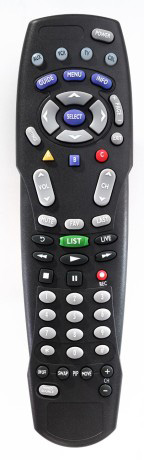

Programming Device Control
  1. Look up the device you want to control in the device code list in this guide.
  2. Press and hold a device key (AUDIO, DVD/VCR, or TV) for at least six seconds. The LEDs for each device key light up, then the LED for the device you selected remains on.
  3. Enter the four-digit code. The device key LED turns off briefly after each key press. You have 10 seconds to press each digit. If it takes longer than that, the remote "times out" and you must begin again.
  4. If the remote recognizes the code, the device key's LED blinks three times. You can now test the remote by pressing POWER. If your device responds (turns off), you have found the right code. If your device does not respond, repeat steps 2 - 3 with the next code in the list.
  5. If the remote does not recognize the code, the LED will turn off. Retry the code (by repeating steps 2-3 using the next code listed for your brand), or search for a device code. See "Searching for Codes".
Searching for Codes
  1. Press and hold a device mode key (AUDIO, DVD/VCR, or TV) for at least six seconds. The LED for each device key lights up, then the key for the device you selected remains on.
  2. Press a function key (such as POWER or Mute). The following function keys are valid for Searching : Play, CH +, Stop. The POWER is recommended. The device key's LED blinks three times, then turns off.
  3. Press UP ARROW. The remote will send the IR command for the function you pressed in Step 2.
  4. If the device performed the function you pressed, press OK. The remote will now control the device you selected in Step 1.
  5. If the device did not perform the function you pressed, repeat step 3. Press DOWN ARROW to retry the previous code.
Checking Codes
  1. Press and hold a device mode key (AUDIO, DVD/VCR, or TV) for at least six seconds. The LEDs for each device key light up, then the key for the device you selected remains on.
  2. Enter 9 9 0 to tell the remote you are verifying the device code. The LED blinks twice.
  3. Press 1, then count the LED blinks and write down the number. If the LED does not blink, the number is 0. This is the first digit of the device code. Press 2, 3, and 4 to obtain all four-code digits.
Changing Volume Lock
  1. Press and hold the device mode key (TV, AUDIO, DVD/VCR, or Cable) corresponding to the device you want to control volume for at least six seconds. The LED for each device key lights up, then the key for the device you selected remains on.
  2. Press Volume +. The device key's LED blinks three times, indicating it has locked the volume control to the device you selected. The AUDIO device key always controls its own volume, regardless of the device is locked to volume control.
Unlocking Volume Control
  1. Press and hold a device mode key (TV, AUDIO, DVD/VCR, or Cable) corresponding to the device currently locked to the volume controls for at least six seconds. The LED for each device key lights up, then the key for the device you selected remains on.
  2. Press Volume -. The device key's LED blinks three times, indicating it has unlocked the volume control for all devices.
Reassigning Device Keys
  1. Press and hold the device mode key (TV, AUDIO, DVD/VCR, or Cable) corresponding to the type of device you want the reassigned key to control (for example, TV) for at least six seconds. The LED for each device key lights up, then the key for the device you selected remains on.
  2. Enter 9 9 2.
  3. Press the device mode key you want to reassign (for example, AUDIO). That mode key's LED blinks three times and turns off, indicating that it has been reassigned.
Assigning a Key back to Its Original Device Type
  1. Press and hold the device mode key (TV, AUDIO, DVD/VCR, or Cable) you want to reset to its original type (for example, AUDIO) for at least six seconds. The LED for each device key lights up, then the key for the device you selected remains on.
  2. Enter 9 9 2. The mode key's LED blinks three times and turns off.
  3. Press the device mode key you selected in Step 1 again. The mode key's LED blinks three times and turns off.
  4. Program the restored mode key to control a device. See "Programming Device Control".
