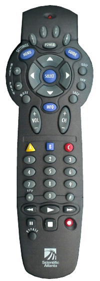

Setting Up Your Remote Control
  1. To set up a mode key, find the four-digit code for your brand of device in one of the programming codes lists.
  2. Turn on your device.
  3. Press and hold the SELECT key. As you hold down the SELECT key, press and hold the mode key for that device until the LED blinks twice.
  4. Enter the four-digit setup code.
  5. Point the remote control toward the device.
  6. Press POWER, PLAY, or CH+ to test the device.
  7. Did the device operate correctly? If yes, press POWER, if necessary, to turn on the device. Press the VOL+, PLAY, or CH+ key to verify that you programmed the best code for your device. If no, repeat steps 1 through 6 using a different setup code.
    Note: If all of the codes listed for your brand of device fail to operate your device properly, go to the To Search for Codes section.
  8. Repeat steps 1 through 6 for each mode key.
  9. Write down your codes for future reference.
