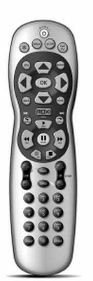

  1. Turn on the TV or receiver you want the remote to control.
  2. On the Moxi remote, press and hold the MOXI and OK buttons simultaneously until the LED at the top of the remote blinks twice.
  3. Using the number buttons on the remote, enter one of the codes for your device from the reference tables (on the opposite side of this pamphlet). When you enter the correct code, the LED blinks twice. If it blinks once, the code was invalid and you must try again.
  4. Press the Power or Mute button on the remote. If the TV or receiver does not respond, repeat steps 2 and 3 using another listed code. Repeat until successful, or use the Programming by Search procedure.
  5. To reset the remote to the original factory setting, enter code 9 9 9 9, and then press OK in step 3.
  1. If your TV or receiver is not listed or does not respond to the codes listed, try programming by search. Programming by search allows the remote to cycle through codes to find one that works with your TV or receiver. Turn on the TV or receiver you want the remote to control.
  3. Using the number buttons on the remote, press 9 9 1 0 for TV, or 9 9 1 1 for audio receiver. The LED light blinks twice.
  4. Press the Mute button. If this mutes the device, go to step 5. If this does not mute the device, press the up arrow to advance to the next code, and then press Mute again. Repeat until the device responds.
  5. Press OK to set the current code and finish.
