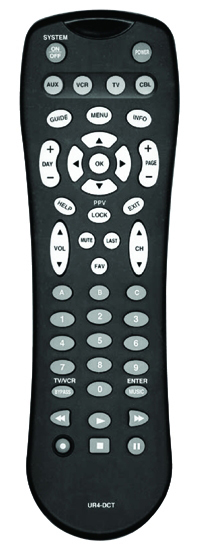

Programming Using the Three-Digit Code Method
  1. Turn on the equipment you wish to program (TV, VCR, DVD or AUX).
  2. Press the corresponding device button (TV, VCR or AUX) and the ENTER button simultaneously for three seconds. The device LED will turn on indicating the unit is ready to be programmed.
  3. Point the remote control toward the equipment, and enter the three-digit code for your brand of equipment.
  4. The equipment will turn off when the correct three-digit code number has been entered. Press the POWER to confirm, and the equipment should turn on or off.
  5. Store the three-digit code number by pressing the same device button once again. The device LED will blink twice to confirm that the code has been stored.
    Note: Try all the functions on the remote control. If any of the functions don't work as they should, repeat steps 2 through 5 using the next three-digit code for your brand.
Programming Using the Auto-Search Method
  1. Turn on the equipment that you want the remote control to operate.
  2. Press the corresponding device button (TV, VCR or AUX) to be programmed and the ENTER button simultaneously for three seconds. The device LED will turn on.
  3. Point the remote control toward the equipment and alternately press the CH+ (or CH-) button and the POWER button. If the correct code number is sent, the equipment will turn off.
  4. Press the same device button to store the code. The device LED will blink twice to confirm that the code has been stored.
Finding the Stored Three-Digit Code
  1. Press the device button (TV, VCR or AUX) you want to verify and the ENTER button simultaneously for three seconds.
  2. Press the INFO button. The device LED will blink a number of times indicating each digit of the code. Each digit is separated by a one second interval of the LED being turned off.For example, 0ne blink, three blinks and eight blinks with an interval of one second of the LED being turned off between each set of blinks indicate the code number 138.
    Note: Ten blinks equal the number 0.
Programming a Second TV to the AUX Mode
  1. Press the AUX button and the ENTER button simultaneously for three seconds.
  2. Press the TV button to display the TV code table.
  3. Point the remote control toward the equipment and enter the three-digit code number for your TV brand.
  4. Store the three-digit code number by pressing the AUX button once again. The device LED will blink twice to confirm that the code has been stored.
Programming the System On/Off Button
  1. Press the SAT button.
  2. Press the SYSTEM ON/OFF button and the ENTER button simultaneously for three seconds. The SAT button will turn on for 20 seconds.
  3. Press the device button and the POWER button you wish to store in the SYSTEM ON/OFF button and repeat this until you stored all the power commands into the SYSTEM ON/OFF button.
  4. Press the CH+ button to save the power commands you stored. The SAT button will blink twice to confirm save.
Programming Channel Control
  1. Press the TV button and the ENTER button simultaneously for three seconds.
  2. Press the VOL - button.
  3. Press the TV button. The device LED will blink twice to confirm the programming.
  4. To return to the original state: If you wish to restore the cable channel control in TV mode, repeat the above steps by pressing CBL in step 3.
Programming Volume Control
  1. Press the SAT button and the ENTER button simultaneously for three seconds.
  2. Press the VOL + button.
  3. Press the SAT button. The device LED will blink twice to confirm the programming.
  4. To return to the original state: If you wish to restore the TV volume control in SAT mode, repeat the above steps by pressing TV in step 3.
Programming for Advanced Function
  1. Press the SAT button to select the SAT mode.
  2. Press the A, B or C button and the ENTER button simultaneously for three seconds. The SAT device LED will turn on for 20 seconds.
  3. Press up to 10 buttons you wish to store. The SAT device LED will blink once for each command entered.
  4. Press the CH+ button to store the functions that are selected. The SAT device LED will blink twice to confirm the storage of functions.
Programming Volume Control for TV/VCR Combination Units
  1. Press the SAT button and the ENTER button simultaneously for 3 seconds. The SAT button will light on for 20 seconds. The next step must be performed while the LED is on.
  2. Press the VOL+ button.
  3. Press the SAT button. The LED will blink twice to confirm the programming.
