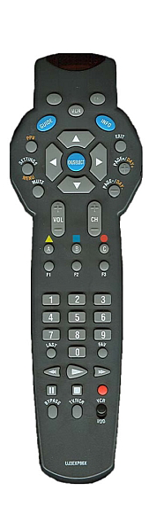

Smart Scan Automatic Programming
The Smart Scan automatic programming method will allow you to cycle through all the available codes in the remote until you find the right TV or VCR code.
  1. Manually turn on the device you want to program the remote for (TV or VCR).
  2. Point the remote control at the device and then press and release the Guide and Info keys simultaneously.
  3. Press the Device Key for the device you want the remote control to operate.
  4. Press and hold the Right Arrow Key until the device turns off. When the device turns off, release the Right Arrow Key immediately. Once you release the Right Arrow Key, the code will be set. If you don't release the Right Arrow Key immediately after the device turns off, the code won't be set and you'll need to repeat these steps.
Manual Programming
  1. Press and release the Guide and Info keys simultaneously and then press the Device Key for the device you want the remote control to operate.
  2. Enter the 3-digit TV code listed for your device.
  3. Press and release the Guide and Info keys simultaneously again to save the code. The red indicator light at the upper left-hand corner of your remote will flash 3 times if performed correctly.
  4. Press and release the Device Key again to test the code you've entered. The device should turn on or off each time the Device Key is pressed. If the device doesn't turn on and off, repeat this procedure using the next code listed for your device. If you can't find a code that works, use the Smart Scan method above.
