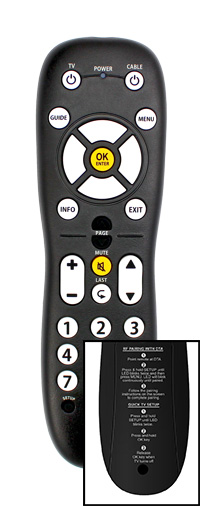

Setup Control of TV
  1. Search for your code above.
  2. Turn the TV On.
  3. Press and hold SETUP until the LED blinks twice.
  4. Enter the first code for your TV from the code list. The LED should blink twice.
  5. Press the POWER key to test your equipment. If the device turns off, setup is complete.
  6. If the TV does not turn off, repeat step 1 using the next code (if applicable) for your TV brand.

  1. Press and hold SETUP until the LED on the remote blinks twice.
  2. Press the POWER key; LED remains ON.
  3. Find your TV brand from the table below and note the DIGIT key assigned to your brand. Press and hold down the DIGIT key for your TV brand.
  4. Let go of the key when the TV turns off. Setup is complete.
If the TV does not turn off, repeat the steps above. If this method does not work, try Direct Code Entry or Code Search.
