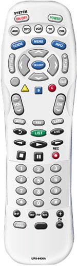

Three-Digit Code Programming Method
The remote control can be programmed by pressing in a three-digit code number that corresponds to particular manufacturers and brands of Audio/Video equipment.
  1. Turn on the equipment you wish to program (TV, VCR, DVD or AUX).
  2. Press the DEVICE button (TV, VCR, DVD or AUX) to be programmed and SELECT button simultaneously for 3 seconds. The device LED will turn on indicating the unit is ready to be programmed.
    • The device LED will turn on for 20 seconds. The next step must be entered while the LED is on.
  3. Point the remote control toward the equipment and enter the three-digit code number assigned to your brand from the code tables.
    • The equipment will turn off when the correct three-digit code number has been entered. You can verify you have selected the correct code by pressing the POWER button; the equipment should turn on or turn off.
      If there is more than one three-digit number listed for your brand, try one code number at a time until your equipment turns off.
    • Store the three-digit code number by pressing the same DEVICE button once again. The device LED will blink twice to confirm that the code has been stored.
Try all the functions on the remote control. If any of the functions do not work as they should, repeat from Step 2 using the next three-digit code number from the same brand list.
Auto-Search Method
If the three-digit code numbers assigned to your brand do not turn off your equipment or the code tables do not list your brand, you can use the Auto-Search Method to find the correct three-digit code number for your equipment by the following steps:
  1. Turn on the equipment you wish to operate.
  2. Press the DEVICE button (TV, VCR, DVD or AUX) to be programmed and the SELECT button simultaneously for 3 seconds. The device LED will turn on.
    • The device LED will turn on for 20 seconds. The next step must be entered while LED is on.
  3. Point the remote control toward the equipment and alternately press the CH+ (or CH-) button and the POWER button. If the right code number is sent, the equipment will turn off.
    • You can verify that you selected the correct code by pressing the POWER button again. The equipment should either turn on or off.
  4. Press the same DEVICE button to store the code. The device LED will blink twice to confirm that the code has been stored.
Find the Three-Digit Code Number That was Stored in the Device
  1. Press the DEVICE button (TV, VCR , DVD or AUX) you wish to verify and the SELECT button simultaneously for 3 seconds. The device LED will turn on.
  2. Press the INFO button. The device LED will blink number of times indicating the number of each digit of the code number. Each digit is separated by a one-second interval of the LED being turned off.
    Example: one blink, three blinks and eight blinks with an interval of 1 second of LED being turned off would indicate the code 138.
