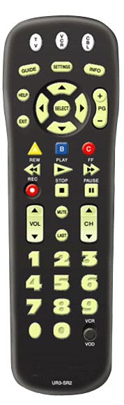

UR3-SR2

Pre-Programmed 3-Digit Code Method
  1. Turn on the component you want to program (TV, VCR, DVD or AUX) .
  2. Press the DEVICE button and the SELECT/OK button simultaneously for three seconds. The corresponding device LED will turn on indicating that it is ready to be programmed. The LED will remain on for 20 seconds. The next step must be entered while the LED is on.
  3. Point the remote control toward the equipment and enter the three-digit code listed for your brand. If there's more than one three-digit listed for your brand, try one at a time until your equipment turns off.
    Note: If the 3-digit code entered is correct, the component will turn off. If it didn't turn off, continue entering code numbers listed for that brand until the component turns off.
  4. After you've entered the correct code number and the component has turned off, press the DEVICE button to turn the component back on. Now test the VOLUME and MUTE buttons for the TV (or PLAY and STOP buttons for VCR and DVD) to make sure they all work. If any of the functions don't work as they should, repeat steps 1-3 using the next 3-digit code listed for your brand.
  5. Store the three-digit code by pressing the same DEVICE button once again. The device LED will blink twice to confirm that the code has been stored.
Note: If the pre-programmed method didn't work or if the code isn't listed, use the auto-search method.
Auto-Search Method
  1. Turn on the component you want to program (TV, VCR, DVD or AUX).
  2. Press the DEVICE button and the SELECT/OK button simultaneously for three seconds. The device LED will turn on indicating that it is ready to be programmed. The LED will remain on for 20 seconds. The next step must be entered while the LED is on.
  3. Point the remote control toward the equipment and alternately press the CH+ (or CH-) button and the MUTE button. If the right code number is sent, the equipment will turn off.
  4. Test functions (Same as for 3-digit code programming method). You can verify that you selected the correct code by pressing the MUTE button again. The equipment should turn on or off. If any of the functions don't work as they should, repeat steps 1-3 using CH + or CH- buttons to find the correct code.
  5. Press the same DEVICE button to store the code. The device LED will blink twice to confirm that the code has been stored.
  6. Now, repeat the auto-search method for those components you couldn't program earlier with the pre-programmed method.
