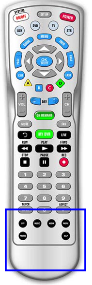

UE C4000/S4000
*Note: To ensure you have selected the correct remote, compare the bottom portion of your remote to this image, or check the remote's battery compartment for its model number.
