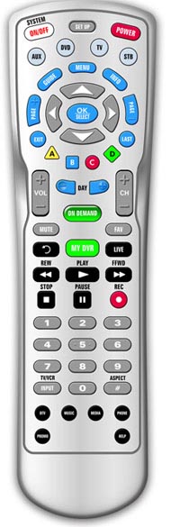

Programming Device Control
The OCAP-4 Remote Control is pre-programmed to operate your Spectrum receiver, an RCA TV, a Toshiba DVD player, and a Pioneer audio receiver. To control devices other than the default brands, perform the following steps:
  1. Turn on a device and, if applicable, insert video media (e.g. a DVD).
    Note: Please read steps 2 through 4 completely before proceeding. Highlight or write down the codes and device you wish to program before moving on to step 2.
  2. On the remote control, press a device key once (i.e. AUX, DVD, TV, CBL or STB); it will blink once. Then press and hold SETUP until the selected mode key blinks twice.
  3. Use the manufacturer's codes to locate the type of device and brand name and then enter the first five-digit code for your device. If performed correctly, the selected mode key will blink twice.
    Note: If the selected mode key emits a long blink, the entry is invalid. Repeat steps 2 through 3 and try entering the same code again.
  4. Aim the remote control at the device and press PWR once. The device should turn off. If it doesn't, repeat steps 2 through 3, trying each code for your brand until you find one that works. If it still doesn't respond, try searching for the code (see Searching for Your Code).
    Note: If the device doesn't have a PWR key, press the PLAY key.
  5. Repeat steps 1 through 4 for each device you want the remote control to operate. For future reference, write down each working device code.
Searching For Your Code
If your home entertainment device doesn't respond to the OCAP-4 Remote Control after trying all of the codes listed for your brand, or if your brand isn't listed at all, try searching for your code.
Use the following device code digits to control a specific device:
  • 0 = Spectrum Receiver
  • 1 = TV
  • 2 = DVD/VCR
  • 3 = Audio
For example, to search for a code for your TV:
  1. Turn on your TV.
  2. On the remote control, press TV once; it will blink once. Then press and hold SETUP until the TV key blinks twice.
  3. Enter 9-9-1. The TV key will blink twice.
  4. Press 1. The TV key will blink twice. Aim the remote control at the TV and press PWR once.
  5. Press and release the CH+ key continuously, then stop when the TV turns off.
    Note: In the search mode, the remote control sends IR codes from its library to the selected device, starting with the most popular code first.
  6. Press PWR. The TV should turn on. Then press SETUP to lock in the code.
    Note: If the TV doesn't turn on during step 6, then slowly press and release CH- to go back through the codes. When the TV turns on, press SETUP.
  7. To search for the codes of your other devices, repeat steps 1 through 5, but substitute the appropriate key (e.g. AUX or DVD) for the device you're attempting to program.
Checking The Codes
If you've set up the OCAP-4 Remote Control by searching for your device code, you may need to find out which five-digit code is operating your equipment.
For example, to find out which code is operating your TV:
  1. On the remote control, press TV once; it will blink once. Then press and hold SETUP until the TV key blinks twice.
  2. Enter 9-9-0. The TV key will blink twice.
  3. To view the code for the first digit, press 1 once. Count the number of times the TV key blinks and write down the number.
    Note: If a code digit is 0, the selected mode key will not blink.
  4. Repeat step 3 four more times for the remaining digits. Use 2 for the second digit, 3 for the third digit, 4 for the fourth digit, and 5 for the fifth digit.
