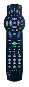

Atlas OCAP 1056

Programming Device Control
  1. Search for your code above by doing the following:
    • Select Device type.
    • Enter your device brand name.
    • Enter your device model number.
    • Click Search.
  2. On your remote, press the mode key for the device you wish to set up.
  3. Press and hold SETUP until TV mode key blinks twice.
  4. Enter the code shown in the dropdown list above.
  5. Press the POWER key to test your equipment. If the device turns off, setup for the device is complete.
  6. If the device does not turn off, try the next code shown.
Searching for your Code
  1. Press the mode key for the device you wish to setup.
  2. Press and hold SETUP until TV mode key blinks twice.
  3. Enter 9 - 9 - 1.
  4. Press Ch+ repeatedly until your device turns on or off.
  5. To save the working code, press and hold SETUP until LED blinks twice.
Locking Volume Controls
  1. Press and hold SETUP key until the mode key blinks twice.
  2. Enter 9 - 9 - 3.
  3. Press the AUD mode key to lock volume to AUDIO.
Using the Master Power Key
The Atlas OCAP 5-device remote control has a unique feature that allows you to sequentially turn up to 5 of your home entertainment devices on or off with a single key press.
Note: MASTER POWER (PWR) only works in the CBL mode. If it is not programmed, only the cable receiver will turn on or off. In any other mode, pressing the MASTER POWER (PWR) once will turn the selected device on or off.
Programming the Master Power Key
  1. Press and hold SETUP key until the last selected device key blinks twice.
  2. Enter 9 9 5. The last selected device key blinks twice.
  3. Press PWR once.
  4. For the first device you want on in the power on sequnce, press a device key (e.g. TV) once. Then press PWR once. For the second device in the power sequence, press its key once (e.g. CBL). Then press PWR.
  5. Repeat step 4 up to four more times to add the second, fourth, and fifth device, as desired.
  6. To save the settings and exit the program:
    • Press TV once.
    • Press and hold SETUP until the TV key blinks twice.
  1. After programming, point the remote control at the devices. Press TV once.
  2. Press PWR once to sequentially turn the programmed devices on or off.
You will see the devices turn on or off according to the programmed sequence.
Clearing the Master Power Key
  1. On the remote control, press and hold SETUP until the last selected device key blinks twice.
  2. Press 9 9 5. The last selected device key blinks twice.
  3. Press and release PWR.
  4. Press and hold SETUP until the TV key blinks twice.
Locking Channel Controls
  1. Press and Hold in the SETUP key until the RED light flashes twice and then release the SETUP key.
  2. Enter 9 - 7 - 3.
  3. Press and release the Channel Up key.
Clearing Out a Device Key
  1. Press the device (TV,VCR,CABLE, AUD, etc.) button and release.
  2. Press and hold the SETUP button until the LED for the selected device flashes twice, then release.
  3. Press 9 - 9 - 2.
  4. Press the device button twice. - Two blinks.
Blinking Back the Code
  1. Press the device (TV, VCR, CABLE, AUD, etc.) button and release.
  2. Press and hold the SETUP button until the red LED for the selected device flashes twice, then release.
  3. Pree 9 - 9 - 0.
  4. Press 1 and count the number of blinks (1st digit).
  5. Press 2 and count the number of blinks (2nd digit).
  6. Press 3 and count the number of blinks (3rd digit).
  7. Press 4 and count the number of blinks (4th digit).
  8. When your device turns OFF, press the SETUP button and release it to lock in the code for your device.
Redefining a Mode Key
  3. Press 9 - 9 - 2.
  4. Press the device key you want moved (TV, VCR, CABLE, AUD, etc).
  5. Press the device key you want to replace. The selected LED will flash twice.
If you want the Audio key to be a TV key: "SETUP" (2 Blinks) 9 - 9 - 2, TV (you want to move TV) Then AUDIO (you want to replace AUDIO).
