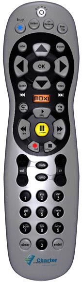

Programming the TV with codes
Program the Moxi remote to control TV power and volume, as well as power, volume, and mute for an audio device.
Note: Some older devices may not be supported. If the device fails to respond to any code, use its original remote to control it.
  1. In front of the TV, press and hold the Moxi and OK buttons simultaneously on the Moxi remote until the LED at the top of the remote blinks twice.
  2. Using the number buttons on the remote, enter one of the codes for your device from the menus above. When a code is entered correctly, the LED will blink twice. If it blinks once, the code was invalid; try entering the code again. If the code was correct for your device, then the device will respond automatically by turning on or off.
  3. If the TV or device does not respond, start over using another listed code. Repeat until successful, or see Programming by Search.
Programming the TV by Search
If the TV or audio device is not listed, or the codes listed do not work, try programming by search. Programming by search allows the remote to cycle through codes to find one that works with the TV or audio device.
Once programmed with two device codes, the remote controls power for the TV and the second audio device as well as volume and mute for the audio device.
  1. In front of the device, press and hold the Moxi and OK buttons simultaneously on the Moxi remote until the LED at the top of the remote blinks twice.
  2. Press the CH+ button slowly and repeatedly to advance through the code list until the device responds by turning on or off.
  3. Once the device responds, press the OK button to set the current code.
  4. Press the Power button on the remote control. If the device does not respond, repeat the previous steps, pressing the CH+ button more slowly.
Additional programming features
To view which device you have programmed for a specific remote control key:
  1. Press the Moxi and OK buttons simultaneously.
  2. Press the Info button, and then press any one of the four programmable keys (Volume +/-, Mute, or Power).
  3. The LED light for the power button will blink back the code, blinking the number of times equal to the first digit of the code, then pausing before blinking the number of times equal to the second digit in the code, and so forth. For the digit 0, the LED will blink rapidly several times.
  4. The default settings for the Volume +/- and Mute buttons control the TV when there is not an audio device programmed. When an audio device is programmed, then the default settings for the Volume +/- and Mute buttons are controlled through that device.
To reset the Moxi remote to the original factory settings:
Press the Moxi and OK buttons simultaneously and hold until the LED light blinks twice, and then Clear three times.
Note: Be aware that this will erase all settings, previously recorded programs and any future recordings scheduled on the box.
