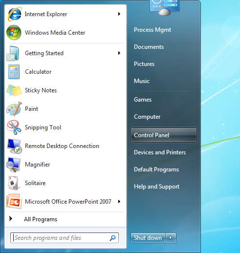

  1. Open the Start menu from the taskbar, then select Control Panel.
control panel

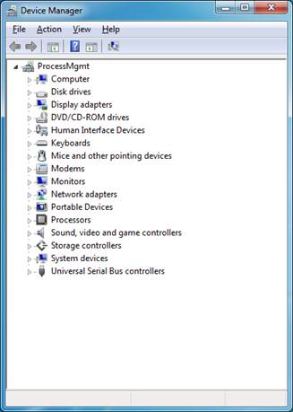

  1. The Device Manager will display all installed and found hardware on the computer.
  2. Locate Network Adapters and select the Arrow to expand the category.
Network adapters

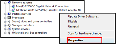

  1. The Network Interface Controller (NIC) will be listed if installed. Right-click the desired adapter, then select Properties, as shown in the image below.
